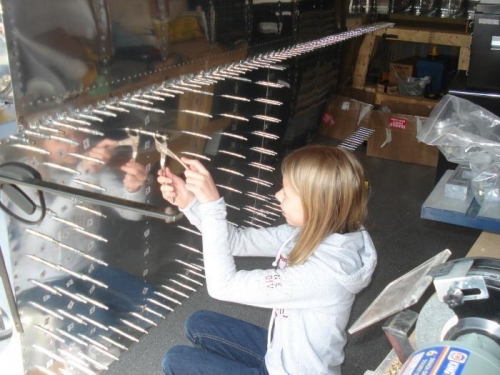

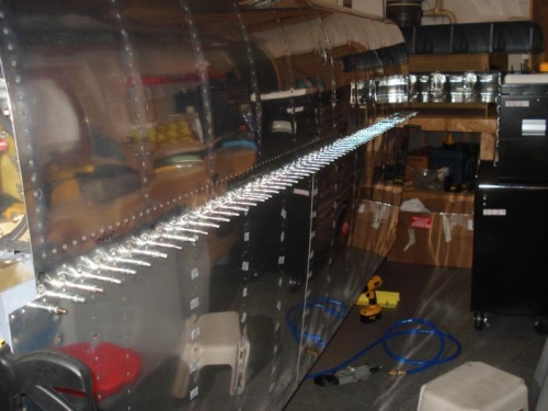

Started by clecoing the skins in every other hole and made sure the scarf joint was good.
I had my daughter Lauren come in and help me buck the rivets. I had an extended off-set back rivet set and Lauren used the bucking bar so that we could back rivet the skins. We started on the outboard edge and moved our way in.
I had all of the rivets set in place and held in place with a piece of scotch tape. Lauren decided that she would mark every one that she bucked with a red X so she knew where she was at.
After bucking every second rivet, Lauren removed the clecoes and I had her insert the appropriate rivets, which were coverd with tape. My yongest Christina lent a hand with that as well.
We took a break as she was getting tired and some of the rivets had to be drilled out as they weren't completely flush. No biggie.
I took the time to squeeze in most of the trailing edge rivets to rear spar. The first few inboard rivets had to be bucked.
Right wing top skin clecoed in place.
Half way there.
Half way there.
Lauren removing clecoes and inserting the rivets.
