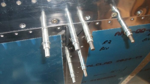

Inboard skin dimpled and scarfed.

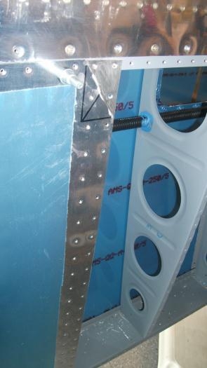

Outboard top skin dimpled and scarfed

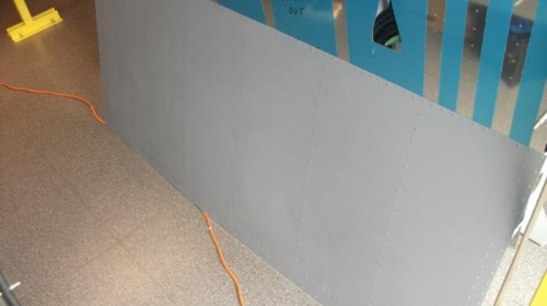

All skins were primed.
