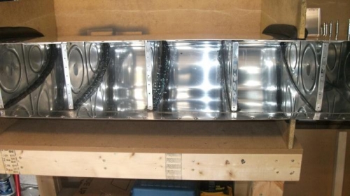

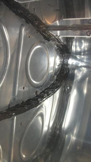

Had to mix two batches of proseal. Prior to sealing up the rivets and the fileting the flanges, I noticed one rivet that I missed...I double checked every rivet and ensured they were all set.
Made sure that a nice bead was placed on both sides of the ribs and complete covereage ovet all the rivet heads.
I taped up the trap door to make sure that it didn't get stuck in place. I'll finish off making sure the capactive plates are good to go tomorrow and install those. I still have to make a notch in the grommets for the wiring. I'll do that tonight.
All interior rib flanges and rivets sealed
Rivet side
Rivet side
Non-rivet side
Non-rivet side
