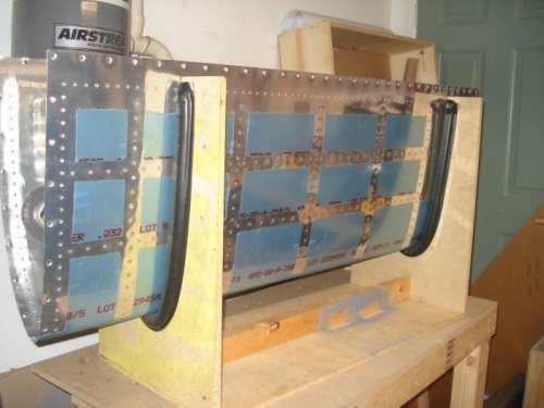

Top skin half riveted.

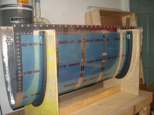

Bottom skin half riveted.
