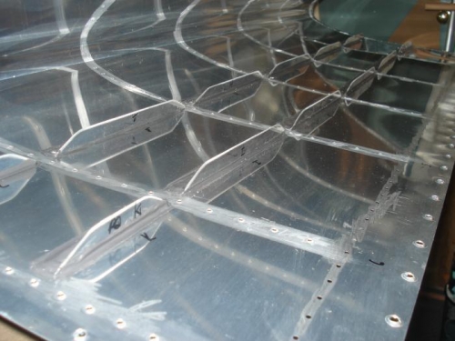

Started today by soaking the rivets in acetone and mixed up a batch of proseal. Two cleocos were removed at a time (front and rear stiffener) and the holes cleaned with acetone. Once dry, I filled the holes with proseal and inserted the clean rivets and seated them as far as they would go.
Once seated, I back riveted the rivets in place. I then cleaned up the prosel from teh skin and back riveting plate, removed the clecoes, and repeated the process.

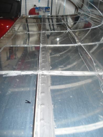

Once all of the rivets were set, I used the remaining proseal and covered up the entire rivet line on the stiffener and smoothed it out. I had enough proseal left to do just the rear stiffeners.
I'll mix a little extra to do the front ones tomorrow when I rivet the fuel drain flange and the fuel cap flange.

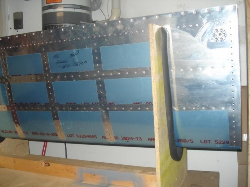

I had to drill out one rivet as it was not sitting flush with the skin. Nice and easy.
Left tank stiffeners
LEft tank bottom skin nice and flush
Layer of proseal over the rivets
