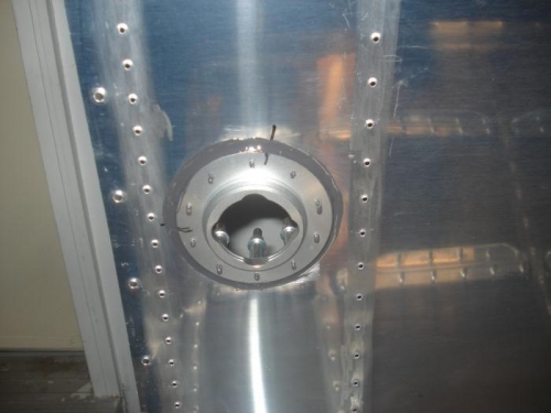

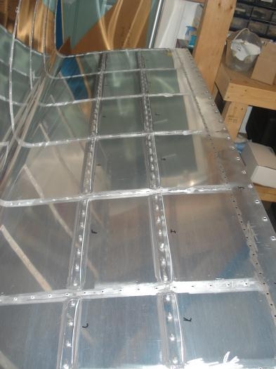

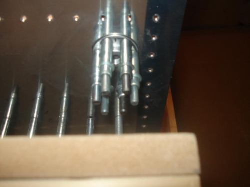

Tonight, I mixed up a 66 gram batch of proseal, scuffed the stiffeners, fuel cap flange and the fuel drain flange, cleaned with acetone and layered on the proseal. Once the proseal was on each piece, I clecoed along the way. All of the parts were 100% clecoed.
Once the proseal sets up in a couple of days, I'll wet set the rivets and add the fuel vent bracket to the fuel tank flange.
Left fuel tank stiffeners prosealed & 100 % clecoed
Fuel cap flange prosealed and 100% clecoed
Fuel drain flange prosealed and 100% clecoed
