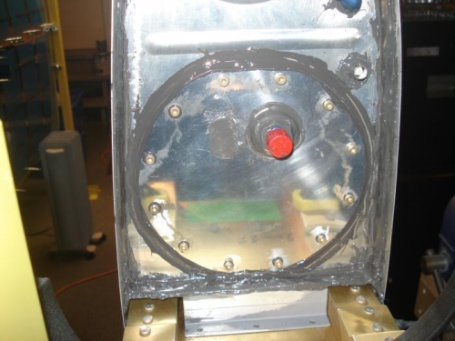

Brief Description:  Right wing fuel tank #20

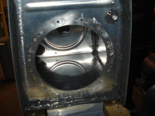

I was waiting for the proper sized NAS1352-08H10P socket head screws for the final assembly of my right tank. The 12P's were too long, so I went to ACS and picked up the 10P's.
After scuff and cleaning both surfaces, I mixed up a 31 gram batch of proseal and installed the fuel tank access cover.
The socket head screws were installed and I'll wait until after I test the tanks for leaks before lock wiring the screws together.
I'll wait a few weeks before leak testing the tank.
Scuffed and cleaned.
Cover sealed and screwed in place.
