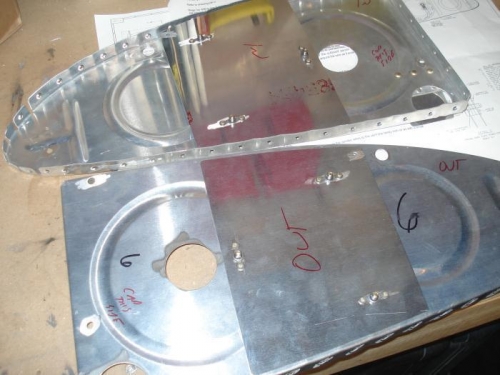

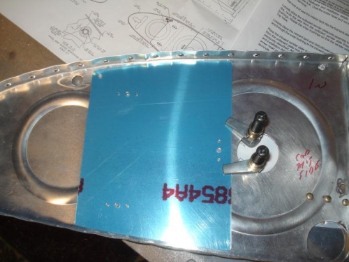

Pulled out the second set of capactive plates. Matched them to the appropriate ribs, marked carefully, and and drilled them in plate for the required nutplates.

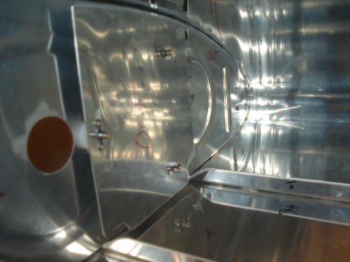

Installed the nutplates on both plates, fitted them into the ribs, removed, deburred, and formed to shape. Clearance looks good all around.
Plates in place for drilling
Plates drilled and temporarily screwed in place
Plates formed to clear stiffeners
