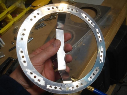

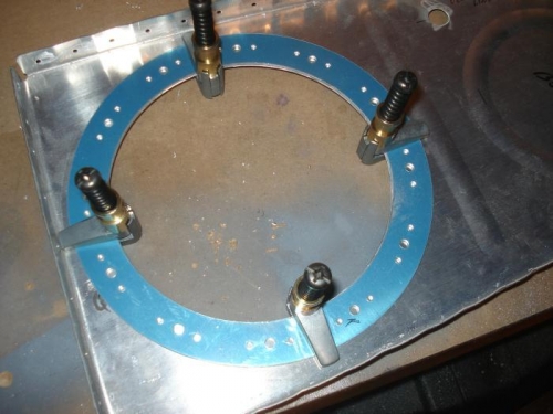

I modified the inboard rib as per DWG 16A using the man killer. I marked the flop tube anti-rotation bracket onto the T-407, which was then clamped and the holes for the nutplates match drilled. (#40 and #21)
Once matched drilled, I countersunk the T-407 for the bracket rivets and set that in place. I then moved onto countersinking the T-407 to accomodate the dimples on the rib. Once everything was done, I deburred all the pieces and then clecoed the encapsulated nutplates to the T-407 and riveted them using 3-4.5 flush rivets
The encapsualted nutplates were purchased from Wicks Aircraft Supply (www.wicksaircraftsupply) and the part number is NAS1473A08. I highly recommend these as it will eliminate any leaking of fuel through the threads of the nutplates.

T-407 clamped after cutting the big hole with the man killer!
Anti=hang up bracket riveted in place
Encapsulated nutplates installed with the bracket.
