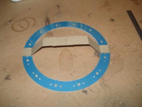

Didn't accomplish a lot this evening. I made a template out of carboard for the flop tube anit-hang up bracket on the fuel tank access panel. Used the tempalte, created the actual bracket, clamped, clecoed and drilled it. It turned out pretty well.

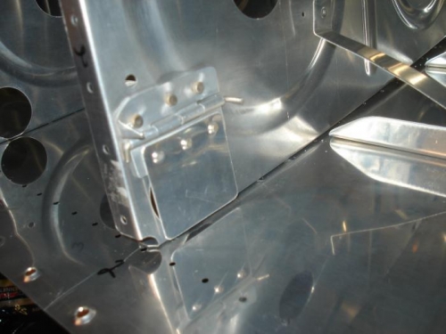

I also completed the fuel trap door for inverted flight. It's supposed to slow down the rate of fuel from leaving this fuel bay into the next. I'll be sure to tape it up prior to sealing the tank so it doesn't get stuck on the tank sealant.
Cardboard template
Cardboard template

Fuel tank trap door installed
