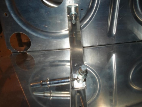

Brief Description:  Left wing fuel tank part #7
Took a tip from Jeff Mitchell's site. Instead of twisted the anti-hang up, I just followed his lead and fabricated I ince and simple bracket, No twist and to chance of cracking.
The stiffeners have since been reversed since the photo was taken.
Anti-hang up fabricated
Clecoed in place
Clecoed in place
Flop tube fitted with anti-hang up..the other stiffeners were reversed
