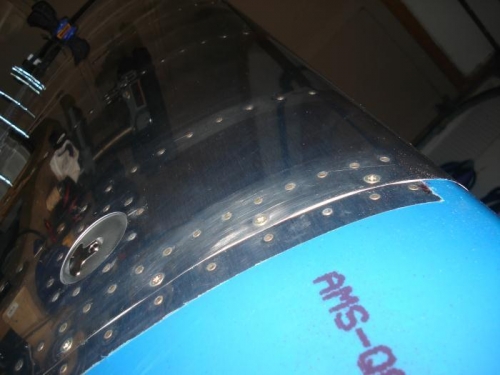

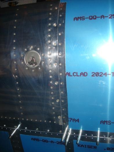

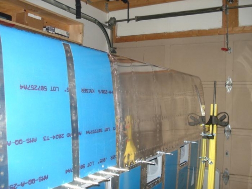

I mounted the fuel tank onto the right wing and initially found that the seam leading edge seam was way out of whack and it wouldn't sit right. After removing the tank and finding some proseal witness marks,
I spent some time cleaning and removing the proseal from the rib and replaced it...a much nicer fit. I did have a little pillowing, but I didn't have the tank bolted down to the spar yet. I'll wait to do that first after the testing before I remedy that.
Right fuel tank screwed in place
Nice fit with the seam
Slight pillowing..it's not bolted down yet either.
