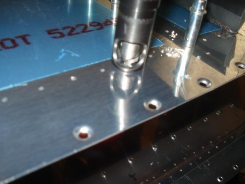

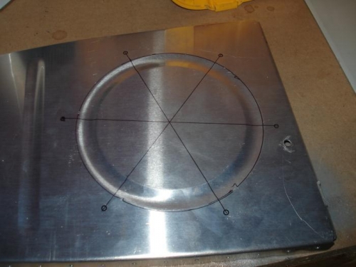

Finished off countersinking the skin to baffle rivet holes to accomodate the flush rivets. I also removed the inboard rib and marked the centre where the fuel access panel will be cut using the man killer.
Countersinking for the 3-3.5 flush rivet

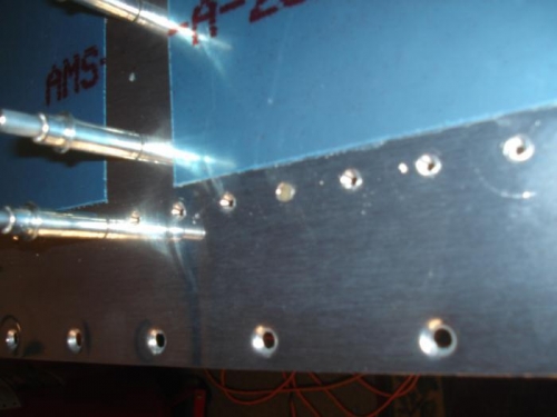

All done - rivet sitting properly with enough room for the proseal.
The inboard rib, marked for centre
