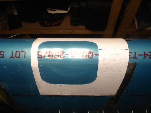

Brief Description:  Right wing leading edge part #5
Second session for the day.
Cut the template to specs and measured the distances from the rear edge and the inboard rib and taped the template. Used the sharpie, got my outline, double checked the measurements and used my dremmel with the cutting disc.
Once done the rough cut, I used the left and right aviation snips which made quick and precise work of the lines. Followed up using the dremmel with a sanding disk and the scotchbrite wheel along with some 600 sand paper. Have a little more to do to get it where it should be.
Template in place
