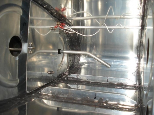

Had some time to rivet the outboard rib for the right fuel tank. I removed every second cleco, cleaned, then filled the hole with proseal, placed the rivet in and squeezed away. Only had enough time for the outboard rib. I'l try to get back in later this evening to finish off the inner rib.
After riveting the outboard rib, I also hooked up the capactive plates, crimped and soldered the wires, and permanantly attached them. Every checks out good. I'll proseal the connector later ion.
Outboard rib riveted in place

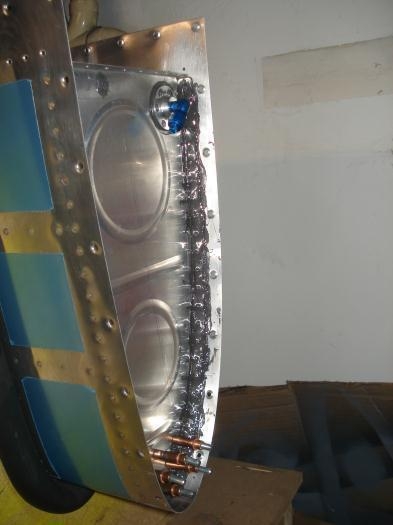

Inboard cap and fuel return line
