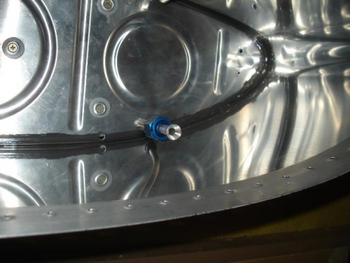

I borrowed Kent's flaring tool...nice tool! I played with it a bit, testing some shorter pieces of line and forming some flares
I installed my vent line and clecoed in the inner rib to ensure that the line met the fitting properly. No issues there.

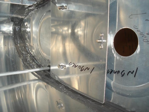

I also installed the capactive plates just to make sure of the fitting and that there were no clearance issues due to the proseal...all good there. I'll remove those one more time, secure the wires, and proseal them in place.

Vent line flared and ready to be installed
Capacitive plates - no clearance issues
