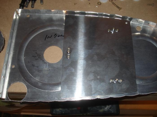

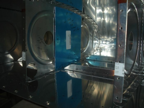

I brought the right fuel tank into the kitchen, and got my head around the installation of the capacitive plates. After test fitting the plates, I removed the inboard and outboard ribs.
I removed some material from the outboard plate due to the stiffeners and you need at least 3/16 of an inch clearance.
I placed in the inboard and outboard plates on the corresponding ribs and matched drilled the holes for the nutplates with a #20 and #40. Deburred both plates and installed the nutplates, making sure they were on the proper side. I also test fit the plates with the screws, nylon, and polyprop.
I also cut the 2 pieces of wire to 15" and two pieces to 48".
