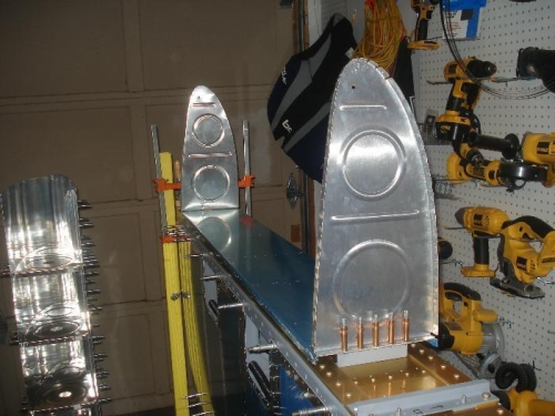

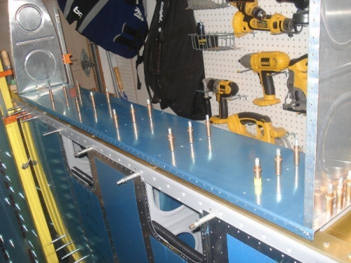

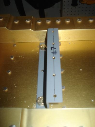

After completing the drilling of the outboard Z bracket for the left wing, I removed the clecoes from baffle/skin and removed the skin and attached ribs. I then moved along and drilled the remainder of the baffle/Z bracket holes.
I'm very happy with the results.
Onto deburring the componets of the left wing fuel tank and onto the capacitive system. I will also be adding the Hotel Whisky bung kit on the outboard rib for the ER tanks.
Left wing fuel tank skin and ribs removed
Z brackets drilled and clecoed
Not a bad technique!  Van's should put this in the plans!
