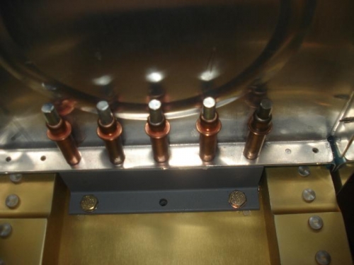

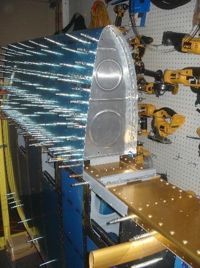

Tonight, I drilled the left wing fuel tank Z brackets, as per Dan Checkway's method. The inboard Z bracket was drilled and clecoed to #30. Once the five holes were drilled and clecoed, I removed the left wing leading edge and drilled the Z bracket holes for the outboard Z bracket.

Inboard Z bracket drilled
Leading edge removed
