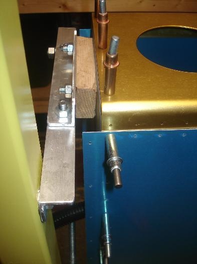

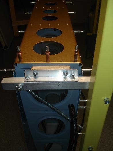

I had to finish the mounting bracket for the win stand and then fabircate the bracket to hold the outboard rib to the other wing stand.
Same as before, a piece of aluminum angle, the same size piece of 1/2 oak, and a couple of bolts and nuts. Had to grind off a significant amount of the heads on the bolts so that the threaded rod would have clearance.
The 1/2 oak gives enough distance for the skins on the outboard rib, not come into contact with the bracket as some folks have found out as they had to cut a slot into the bracket to allow the skin to sit flush.

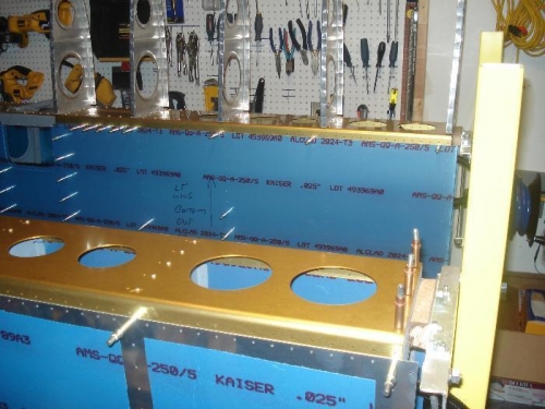

Both wings are in the stands, both are final drilled to #40, and now on to finishing off the leading edges. Things are really happening fast now. It's going to come to a screaming slow down once I'm ready for the tanks.

As you can see, the skin doesn't touch.
Both wings in the stands
