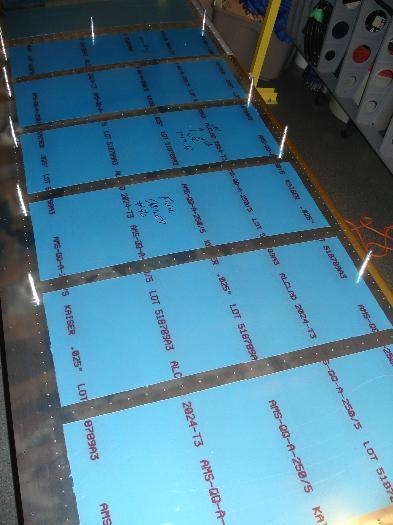

I clecoed the W-703 to the right wing and added clecoes every four holes. I final drilled to #40 and then used my soldering iron to remove the vinyl from the rivet line so that I can dimple the skins.

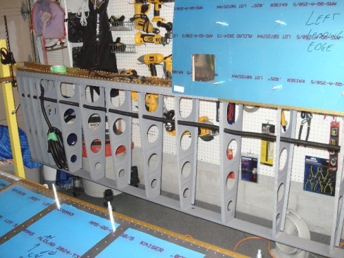

Once I completed that, I move over to the left wing in the stand and decided to run the conduit through the ribs to support the wire run. What a pain that was. I actually bled on that one after I ripped my finger down the rib. Lots of extra conduit at the fuselage end and about a foot left at the wing tip end.

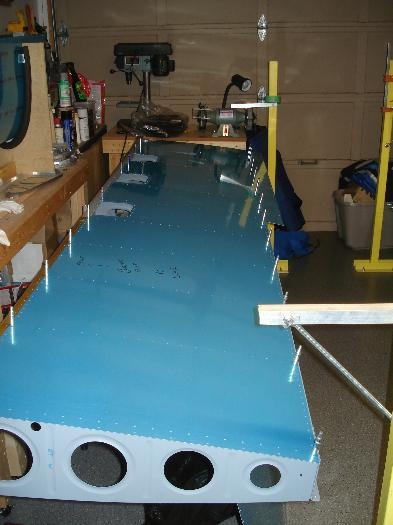

I removed the top skins and flipped the right wing and clecoed on the bottom skins. Waiting for my Aircraft Spruce order to arrive...some extra clecos are on the way.
Top skins of the right wing final drilled
Conduit installed in the left wing
Right wing bottom skins clecoed on.
