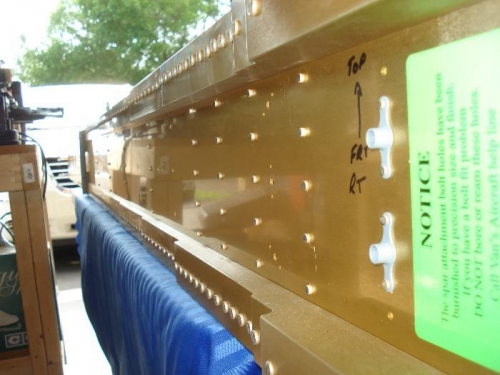

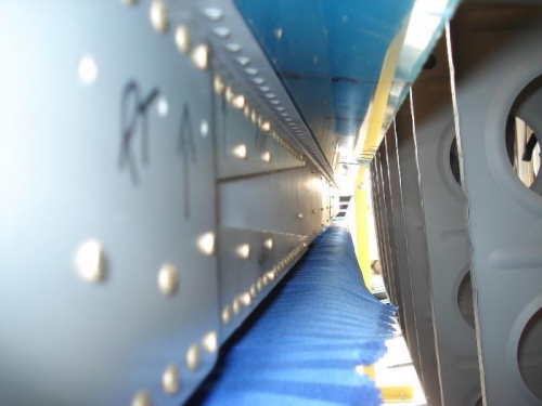

Brief Description:  Right wing skeleton prep part #2
Got into the garage and was able to get the right wing rear and front spar riveted to the ribs. I have one rivet that I'll probably have to remove, but I'll leave that up to the MDRA inspector to make the final call.
Now that the right wing skeleton is riveted together, I'll install the second wing stand and get both wings into the stands. Also going to run the plastic ducting through the ribs for the wires in both wings.
Moving onto the wing doublers
Right wing main spar
Right wing rear spar
