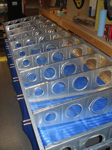

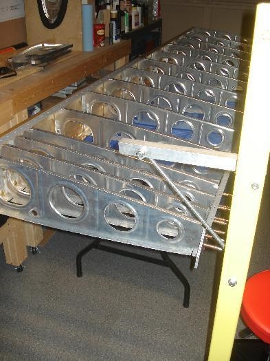

After getting all of the fluting done, I retrieved the left wing spar and the left wing rear spar and set them on the table. I oriented my ribs as per the plans where they had previously been marked.
I clecoed the ribs to the main and rear spar and final drilled to #30. I also had to drill a few new holes on the inner rear ribs where the meet the rear spar.
I repeated the process for the right wing.
Now more deburring for the spars and ribs. I will hopefully get to cleaning, prepping, and priming the ribs in the next couple of days.
Left wing skeleton
