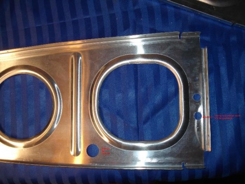

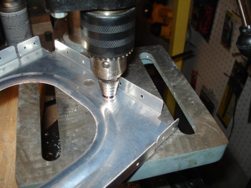

I also decided to drill out the holes for the conduit. I made a simple cardboard template, drilled to a #30, and marked every rib. After marking and drilling the pilot hole, I used my step drill and opened the hole up to 3/4 inches.
After completing the conduit holes, I also opened up the tooling holes to 7/16 to accept the grommets to run my wiring for landing and wingtip lights. I just used a black sharpie, made a line on the 1/2 step on the bit and made sure Ididn't go past it.

Template made and a hole drilled for #30
Opened the tooling holes to 7/16
3/4 conduit hole and tooling hole opened.
