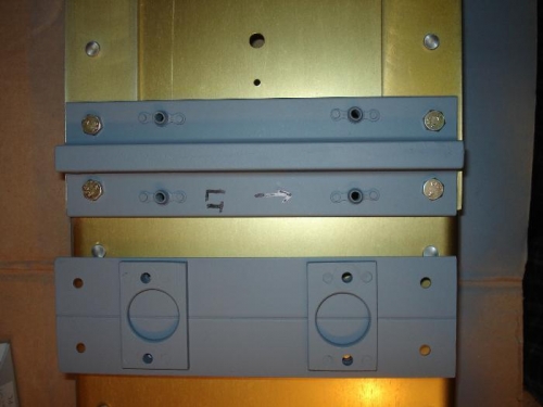

Drilled the pilot hole and bolted the tie-down after squaring it up. Used some heavy duty clamps to make sure it didn't move this time. Drilled and bolted as I went along.
Spacers were also drilled and bolted. Cleaned, marked and primed. I rivted the nutplates to the assembly and tested both tie-downs for fit. P E R F E C T !

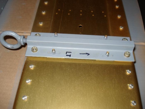

I then grabbed my tap and die kit and secured the tie-down into the vice. Marked one inch on the tap and went to work with the oil. Tested with the tie-down ring from Van's and all is good.

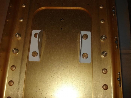

Grabbed the hardware and secured the assembly to the spar and also secured the bellcrank brackets. I will torque and seal the assembly down later as I will be removing a bellcrank bracket in the future to run a bracket for the Safeair pitot lines so they don't interfere with the bellcrank.

Spacers and nuplates all riveted in.
Ties downs assembled and ring is tapped.
The bellcrank brackets are in place
