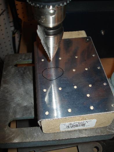

After match drilling the W-707E doubler and tracing the holes for the aileron pushrod, I used a unibit to make a small hole. Make sure you use a 2x4 under it.

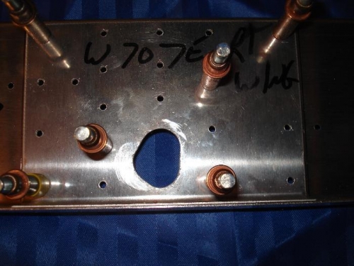

Clecoed the W-707E doubler back onto the rear spar and used my Dremmel to sand the doubler down to match the rear spar. The Dremmel certainly makes quick work of this!

Used the unibit to remove some of the material

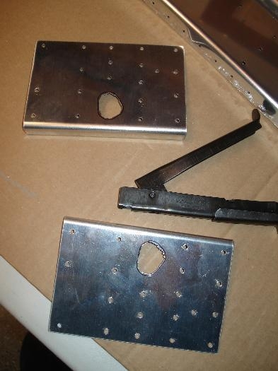

The nibbler does a great job removing metal.
End result...need to debur now
