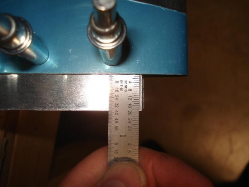

Both sides of the 716 were measured, giving me 19/32 of an inch from the edge of the skin at both ends....happy with that.

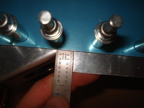

Same went for the other side and I used a square to make sure the ends towards the trailing edge were lined up.

The 716 nearest the 710
The 716 nearest the trailing edge
