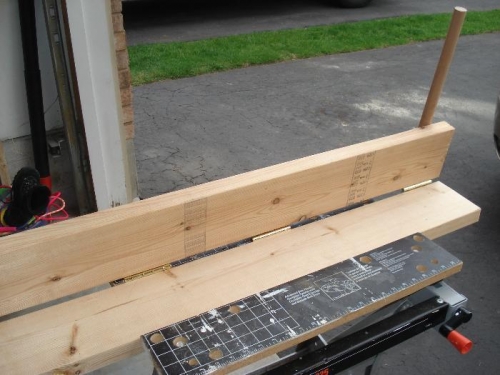

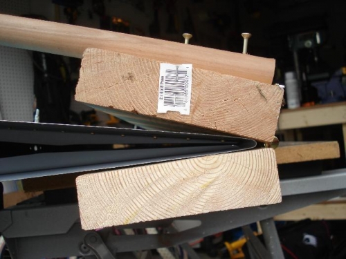

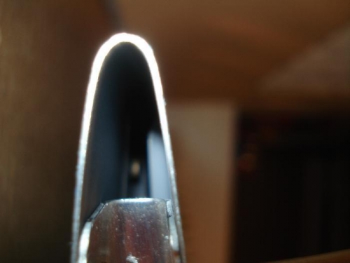

Started with building the "bending tool" I used 2 x 6, but placed it in the workmate, leveled it and had close to 12 inches for the bottom of the skin. Went in stages and felt the skin "bending". Have a nice radius and it marries up with the spar nicely.
The two handles make it an easy bend.
Bending tool
Bending tool
Bending the trailing edge of the rudder
End result.
End result.
