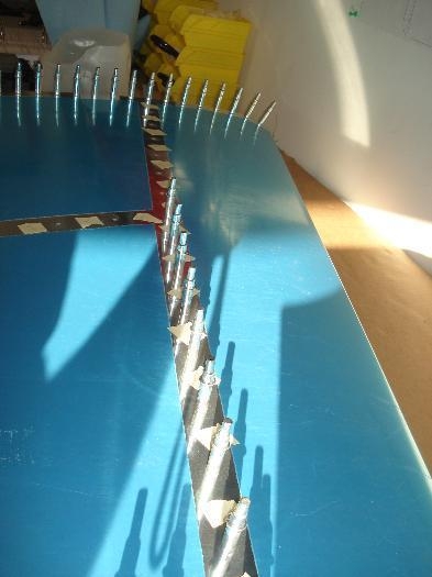

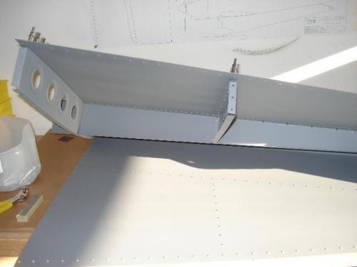

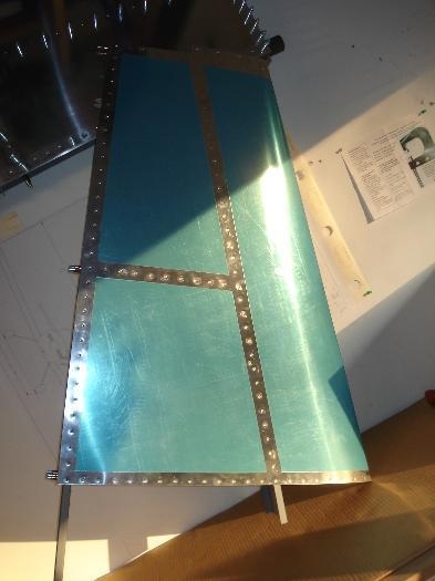

Brief Description:  Riveted the VS-801 skin to the VS skeleton
Clecoed one side of the VS-801 to the VS-702, VS-704, VS-705, VS-706, VS-707/ Started from the intersection of teh VS-702/VS-707 and moved towards the tip. Went the other direction and finished the rest off.
I used the squeezer to set the flush rivets on he VS706 and the VS-704/705...what a difference.
I'll leave the rear spar clecoed for now so that the MDRA inspector can clearly see all of the work.
