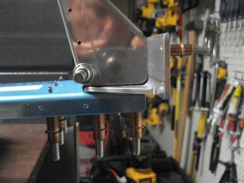

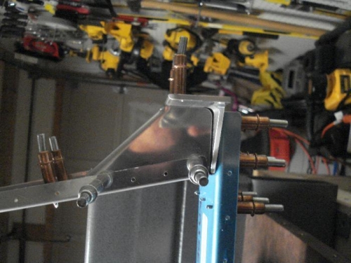

Clecoed the R-704, R-405, R-710, R-717 and the platenuts.
Prepared and fluted the R-703 tip rib and clecoed it to the R-802. Enlarged the holes that attach the R-703 to R-802. Clecoed the R-713 counterbalance skin to the R-703. Forward flange of the R-703 had to be fluted quite a bit to line the holes up with the R-713.
Final drilled the holes for the R-703 and R-713.
