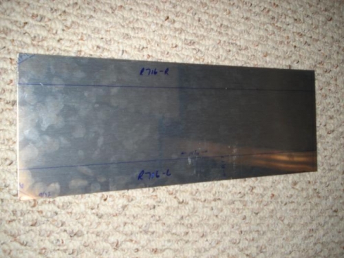

Had a tough time figuring out which piece of sheet metal out of the trim kit to use for the R-717 spacers and the two R-716s rudder bottom attach strips. None of the aluminum sheets were labeled. After careful research and measurements, I selected the right sheet and started my measurments.

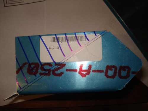

I also measured the trimming of the R-710....thank goodness I didn't cut my original marks. I reviewed what others had done with the 710 and learned that the blueprints set you up to lose the minimum edge distance required. I moved the cut line further away to ensure that the MED will be met for the rivets. I don't know why Van's doesn't send a supplemental with this?

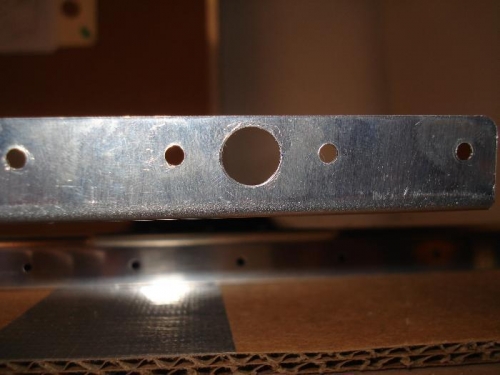

The bottom most rod end hole was enlarge to 3/8s using a Unibit in steps.
R-716s
R-716s
2nd  line above was the cut line
R704 enlarged to 3/8
