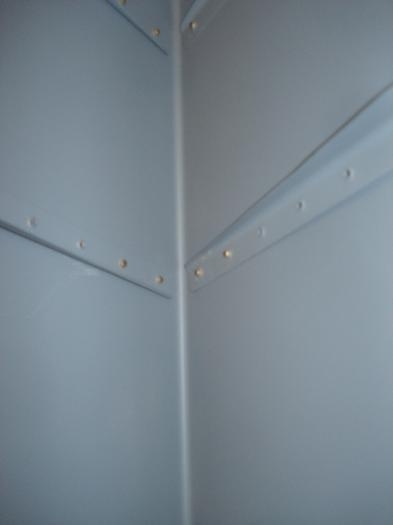

First 2 rivets only for both sides a the trailing edge.

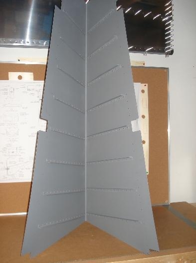

All rivets set
All rivets set

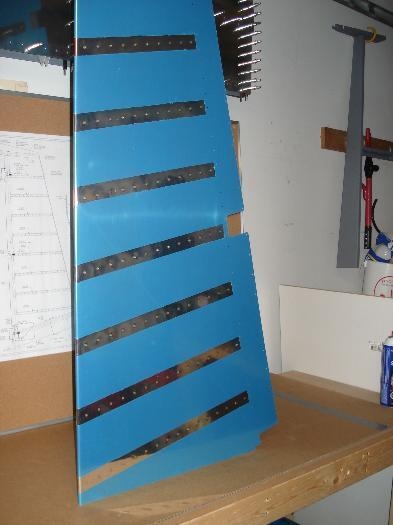

Nice and flush....
Nice and flush....
