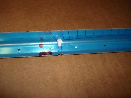

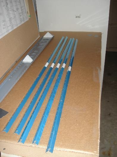

I started with the lengths of R-815 A-H, read the plans a few times and started to identify and mark the stiffeners for cutting.

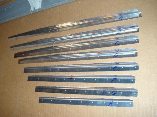

The band saw made quick work of the cutting to give me 14 stiffeners from A-H. The stiffeners were labeled, de-vinyled and taken to the scotchbrite wheel. The corners were given a radius and the edges were knocked down.
Stiffener lengths ready for cutting.
Carefully marked for cutting
End result of cutting
