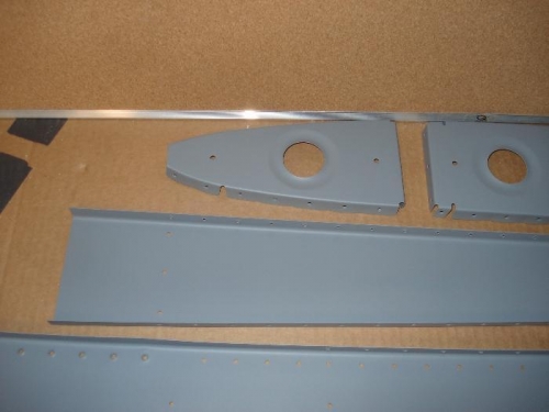

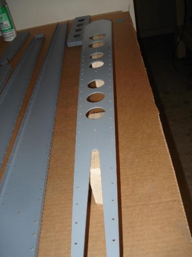

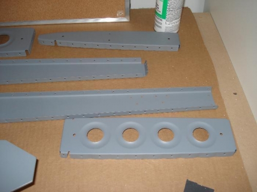

Date:  4-30-2010
Number of Hours:  1.50
Manual Reference:  Page 6-4
Brief Description:  Scotchbrited, cleaned and primed
Scotchbrited all the VS components, cleaned with soapy water and an SOS pad, rinsed with clean hot water, air dried, then added two coats of self-etching primer. The VS-808PP got a coating of laquer as well for a little added protection.
