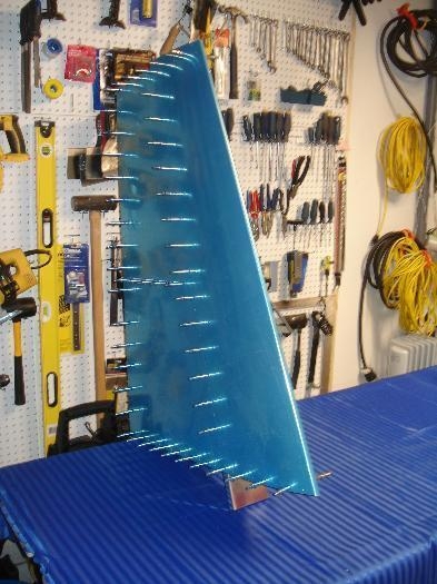

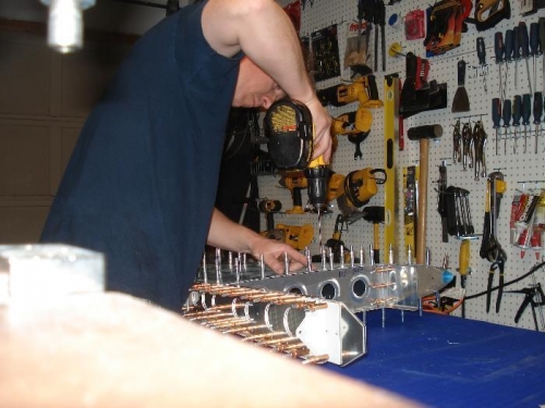

Brief Description:  Finished final drilling the VS skins
Clecoed the VS 808PP spar doubler to the VS 803PP along with the 410, 411, and 412 hinge brackets. Used the VS 803 and 808 as a guide and drilled the two holes for the VS 410 hinge bracket. Fluted and deburred the ribs and clecoed.
Final drilled the VS 803, 808, 410, 411, and 412 to #30 as well as the rib spar attach holes.
Clecoed the VS 801 skin to the assembly, final drilled the skin.
Now to disassemble, debur, dimple, countersink, clean prime and rivet.....
Final drilling the skin
VS final drilled.
