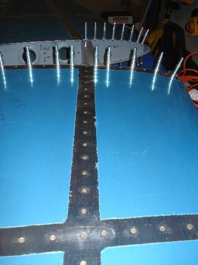

Brief Description:  Work is halted on the HS until inspection
There is not a whole lot more I can do until after the I have an inspection from an MDRA inspector, which wont be for some time.
I removed the rest of the vinyl off and tried to polish the skins abit. Over all, I'm pretty satisfied with the work so far. I will be removing the AN3 bolts and replace them with AN3 drilled bolts so that I can install cotter pins.
It's a requirement in Canada for all bolts that can rotate, be safetied with a cotter pin.
The flush rivets
The flush rivets

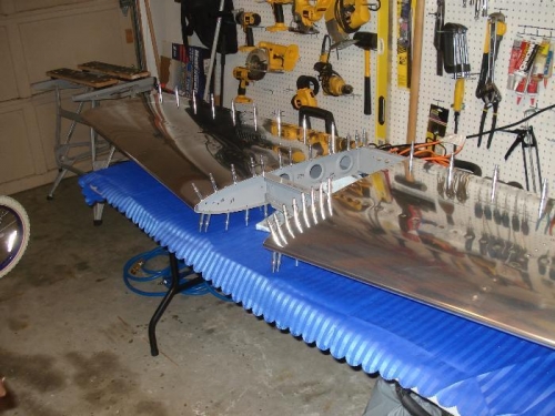

Going to be put away in storage
