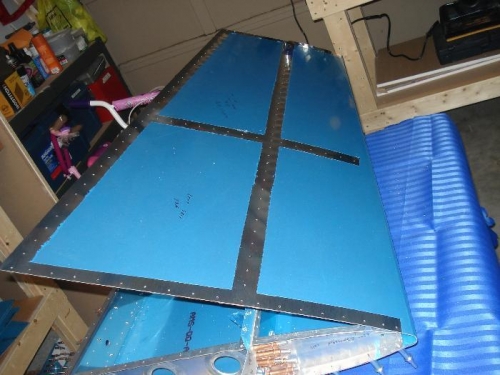

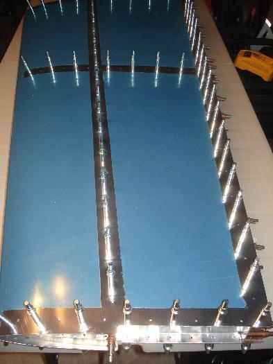

Brief Description:  Final drilled skins
Final drilled the 801 left side skin to all components. Also grinded down a soldering iron and removed the vinyl from the skins. Used a metal ruler with a hole in both ends so that it could be clecoed to the skins. Soldering iron worked well, but becareful not to scratch the skins.
Skin de-vinyled
Skin de-vinyled
