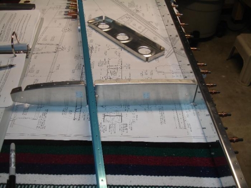

Date:  3-14-2010
Manual Reference:  Page 6-2
Brief Description:  Ribs prepared
Ribs HS-404, 405, 706, 707, and 708 all deburred. Ribs identified left and right side of the HS.
Using the dimensions in Sec D-D, hole locations marked. Holes drilled to #40.
HS-702, HS 603, HS 706, 707, and 708 clecoed together.
All rib holes drilled to #30, except HS-708 to HS-603 holes
