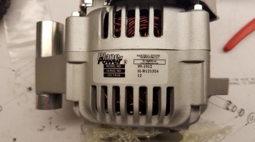

Brief Description:  Install fuel system components and alternator
- Installed the engine driven fuel pump fittings and hoses, coating all o-ring seals with Fuel Lube.
- Installed the VA-128 fuel pressure restrictor fitting at the engine driven fuel-pump KB-090T fitting. Installed the fuel pressure line between the restrictor and the fuel pressure sending unit.
- Installed the primary alternator
Primary Alternator
Primary Alternator
