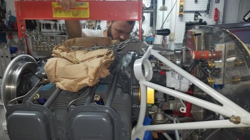

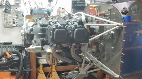

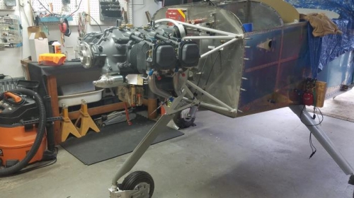

Installed the Dynafocal mounts and with Connor's help used the engine hoist to get the engine mounted on the airframe. We put the bottom mounts in first per the instructions, but it was still pretty tough to pull the top 2 mounts into alignment.
