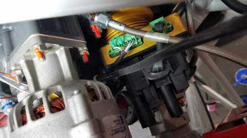

Brief Description:  P-Mag Wiring
Installed the wiring for both P-Mags, connecting them to the switch panel and the VP-X wiring harnesses. Also installed the manifold pressure sensing lines. I needed to do all of this first before oil and fuel lines as the P-Mag access is basically underneath everything else on the accessory case. It will be tough to remove these in the future.
Right P-Mag
Right P-Mag
