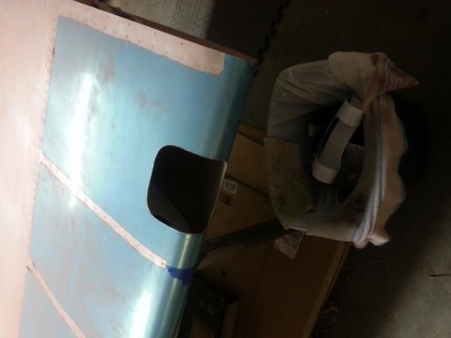

Applied the template and cut out the wing leading edge. Filed and deburred with scotchbrite. Match-drilled the screw holes using the lens backing strips. Match drilled the lens and widened the wing skin holes out to #6 and dimpled.
