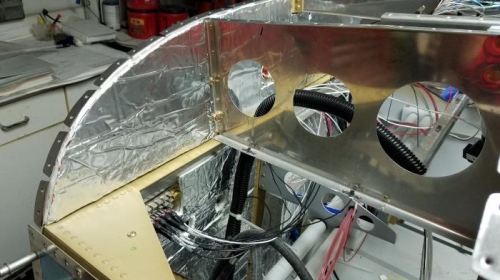

Brief Description:  Install sound dampener on cockpit side of firewall
- Cut patterns using construction paper and used them to cut the sound dampening 3M panels that adhere to the back side of the firewall. Prepped firewall with degreaser and applied. See pictures.
3M Sound Dampener Installed on Firewall
