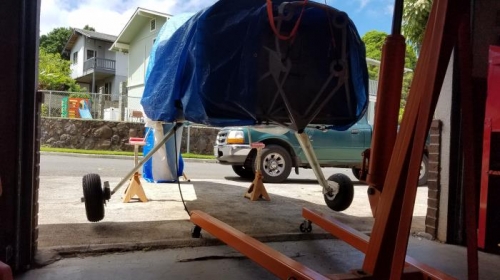

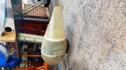

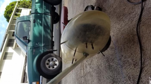

Installed and aligned the Main Wheel Fairings. Since I had the airplane suspended and leveled I also completed the procedure to align the Main Gear Leg Fairings. Installation was straight forward, but time-consuming, because the existing fairing cuts were undersized and required a lot of iterative trimming. I still have some trimming to do around the tire cut-out as well as installing nut plates and countersinking.
Off the mains and leveled
Left main fitted
Left main fitted
Left main from the rear
