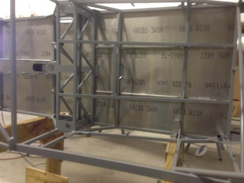

There are many holes to be drilled into the three skins of the
forward fuselage. Be sure to have plenty of sharp drill bits
on hand as they will become dull drilling into the 4130 steel.
SPA recommends cobalt drill bits and that is what I ordered
from McMaster-Carr. Still waiting for them to show up. I wore
out three of the standard drill bits they sell. Sure hope the
colbalt bits last a lot longer.

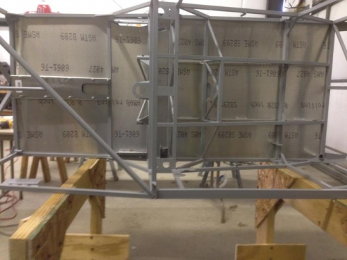

I clecoed the fuel line tunnel and the six floor stiffeners into place
The tunnel cover will stay off until I have the engine mounted
and my fuel lines run.

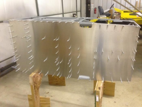

Lots of holes
Lots of holes
Fuel line tunnel and floor stiffeners
Another view looking inside
