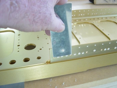

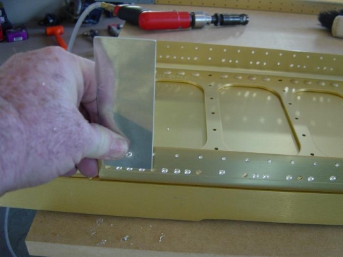

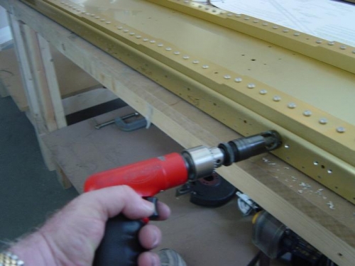

Begin Countersinking spar flanges for nutplates and skin & tank attach. Lots of Holes!
Countersink for nut plate attachments
Make dimple test plate for skin attach countersink depth
