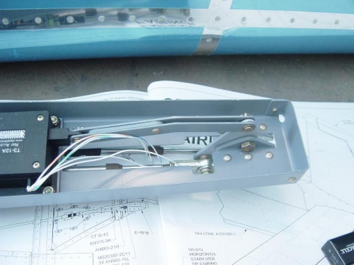

Number of Hours:  6.00
Manual Reference:  Sec 11-8 & 9
Brief Description:  Sec 11-8 step 8 Sec 11-9 all
Asswemble and rivet the elevator trim tray, then install the trim servo and install, attach and adjust the trim cables. HAd some difficulty with the an4-7 rivets and had top replace one w/ an3 bolt, also the belcrank was too tight to allow for two washers, so I thined the belcrank using the belt sander and then put in 2 'thin/light' washers, allows for free movement with no binding. (Took too much extra time). Also the two F1095G brackets were too wide and interferred with the cables, used the dremmel to 'relieve' them where they rubbed against each other.
Final product after too many hours for such a little part!

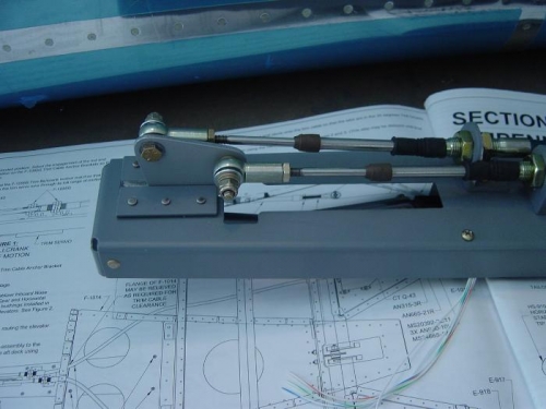

underside
underside

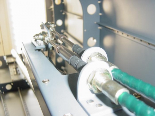

installed on the aft deck
