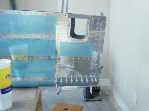

Riveted Left side skins to Tailcone. Backriveted everything except for the past 2 bulkheads and the aft skin, also a couple of rivets that were behind the stiffeners and couldn't be reached witht he back rivet drive. All in all it came out great - even the parets where I had to drive/buck rivets.
both skins complete!

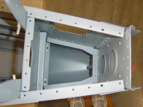

Aft section completed , drove these w/ flush sedt and bucked them, not room to back rivet
