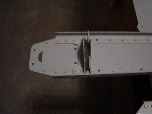

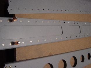

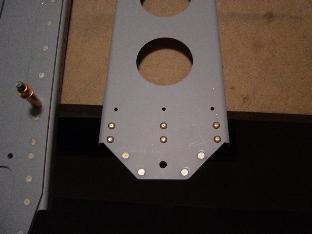

ran out of 426 AD 4-7 rivets, should asrrive Mon, drilled out 5-6. as they were not straight/flush
Missing AD 426 4-7 (12) caused by mistake countersinking too many holes requiring flush vs universal head
front spar doubler riveted
Bottom rudder attach bracket and rudder stops
