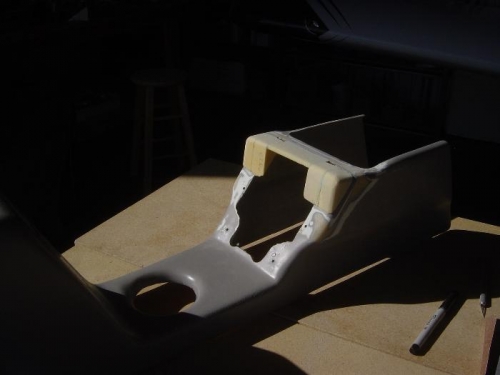

My friend Neal Colliver (NZ) tipped me off to a problem that I wasn't aware of. i.e. the mounting angle of my Tru Trak programmer. Neal had his mounted in a similar fashion and found that due to some internal position sensors within the unit that it would not behave appropriately. I checked the installation guide, and sure enough max angle is 12 deg. (mine was at 45-50 deg). So I disconnected all of the switches and AP and removed the center console. I then removed the switches and AP from the faceplate. I took it to a friend on the field who has a metal brake, and after covering it in masking tape I was able to bend the upper portion 40 degrees so that when the AP is mounted it will be near verticle. The good news is that I won't have to remake the faceplate and paint and silk screen!!!!. The next step was to build up the upper portion of the mounting deck to match the bent face plate. I used some foam blocks cut to shap and installed with 'bondo' then sanded flush with the console profile. Then I cut several strips of fiberglass cloth on a 45 deg bias, and layed them up in alternating/overlapping patterns over the built up area. It will cure tonight, and then I'd Dremel/chisel out the old fiberglass behind it and begine to prepare the new mounting deck for paint and remounting.
Upper portion of center console built up for vertical Autopilot mount
Faceplate bent so autopilot is now vertical
Fiberglass layed up over foam 'forms'
